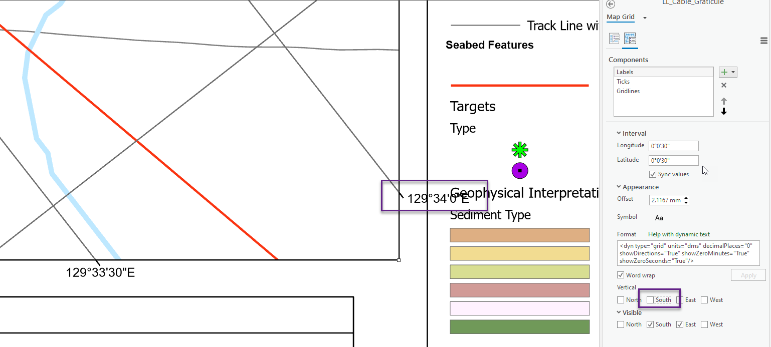

I am trying to create a map series following a linear feature, with each page rotating to a set value.
This has worked fine, however previously in Arcmap I would have all of the grid labels on the X axis oriented horizontally and those on the Y axis oriented Vertically (to maximize space for the data frame).
In ArcGIS Pro this option seems to be related to whether the label is on an E,W,N or S grid line , rather than top,bottom,left or right axis ... and as such seems to be producing odd results, that I cannot rectify:
Ideally, as in ArcMap, i would want these labeled to automatically be oriented in line with the frame border ... not the same as the other labels of the same oriented grid-lines.

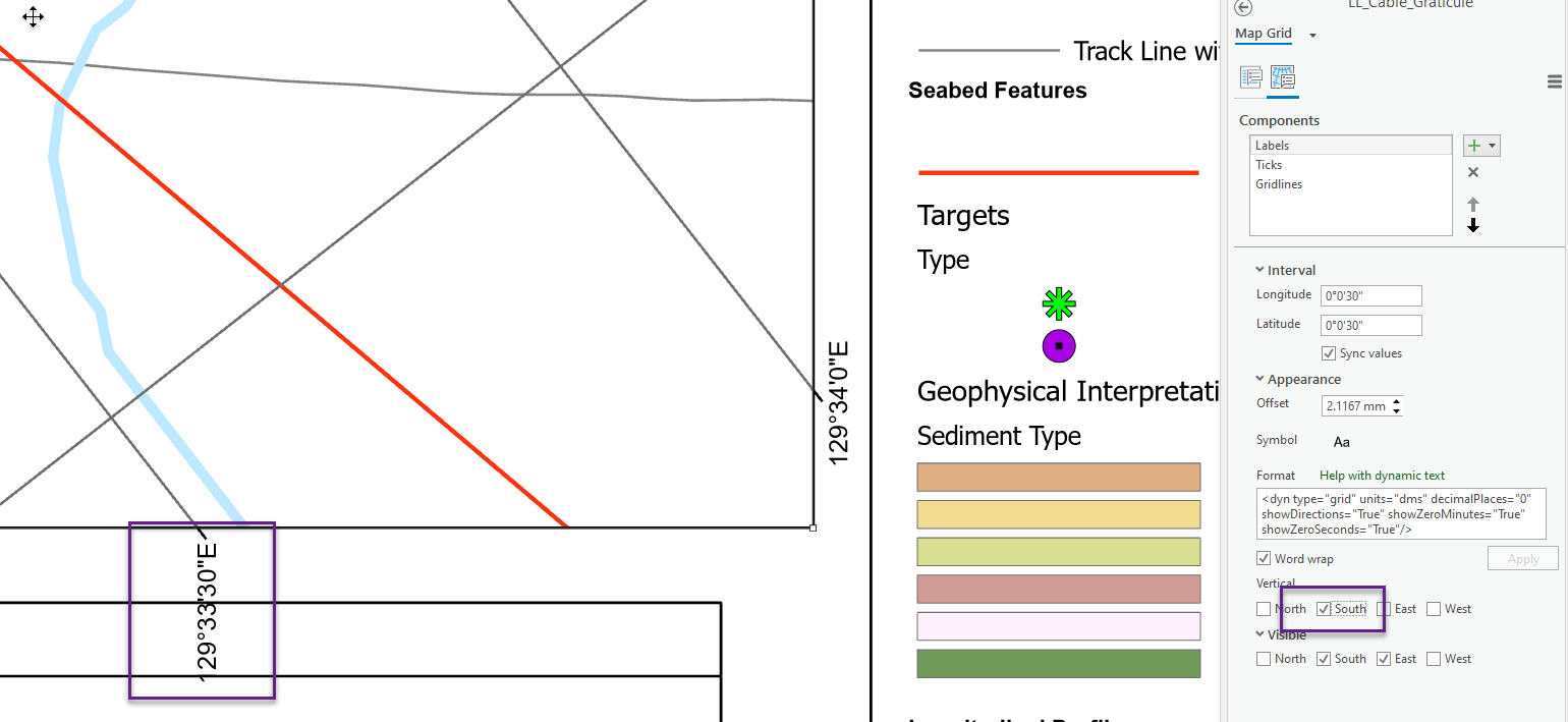

AdamDavis
Hi Tom,
Thanks for the detailed reply but it's not addressing the issue.
What we are looking for is a set of grid properties that give a sensible looking output at any rotation angle.
So we don't waste too much whitespace around the dataframe we want all text to sit "tight" to the dataframe. So we are more concerned with the orientation of the text in relation to the piece of paper rather than the grid itself. We want to be able to set it up once and then whatever angle of dataframe it should do that.
Imagine hundreds of pipeline/cable strip charts.
This is at 266 (-94 in Esri parlance) - all looks good.
Set it to 0 degrees and it looks terrible.
In certain angles where a line hits 2 sides of the dataframe then there is no way to easily get the right output (you could make 2 grids but that's a lot of work).
South with vertical on/off and never looks OK.
We are a company that has a software product that automates the production of these alignments sheets in Desktop/Pro. If there is no option for this in Pro we will have to code to back calculate which side the text is on and align it appropriately (and in certain situations clone the grids and reverse the properties to allow for the above). Not a huge problem but a shame to have to do it.

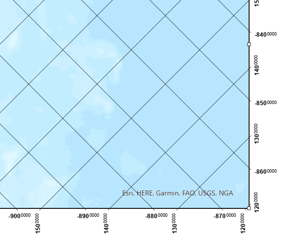

ErmelindaEspinoza
Hello Everyone.
I'm on ArcGIS Pro 2.8.0 and having this same problem.  Grid labels are not well aligned to the layout frame. Labels.PNG
I hope this issues is fixed soon.

TomBole
Hi everyone,
We have added a new property to grid labels - "Draw parallel to grid edges" and to ticks - "Draw perpendicular to grid edges". These properties are new with ArcGIS Pro 2.9. I hope these properties will help with your workflows.
Tom
AdamDavis
Hi Tom,
I saw that on the What's new page - great addition. Did a quick test on the text and looks good.
Adam
