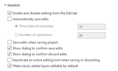

ArcMap.  You can open table and field calculate on an attribute outside of an Edit Session. However, it will prompt you that you cannot reverse it calculation once you have done it.
In ArcGIS Pro this is not the case in all edits.
You can change a setting that forces you to toggle the Edit button to start editing.
But you can create multiple features, update tables, and make thousands of changes. The save and discard button stay grayed out.
Is there a way to adjust editing in Pro so you have to acknowledge every single safe, just like ArcMap?  I would like to use Pro more. But for reasons just such as this it is not suitable for serious GIS editing.
Even with the settings as shown below the system instantly adds my edits to the database with no turning back.
Tags (1)
Robert_LeClair
Esri Esteemed Contributor
By chance are you using Non-versioned editing?  If so, this is expected behavior.  If you're doing versioned editing, then save/discard is available.  Same for fGDB's and shapefiles.
RobertBorchert
Honored Contributor
We have gone with Un-versioned Data for much of our data being used in Portal and edited in the field.  Your answer makes sense. I tried it with one of our versioned dataset and it works the way it should.
