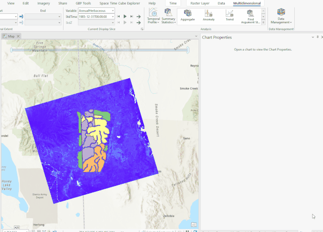

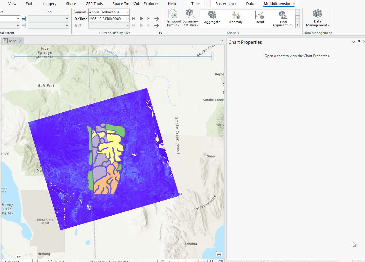

I built out a couple Multidimensional Multivariate Rasters and then use the Multidimensional toolbar to make Temporal Profiles super fast and it is pretty slick.
I now want to be able get a temporal profile in script for a given polygon to add to our reporting tool.  So basically simulate the above gif and get back a SVG of the chart that I add to our larger PDF.
I am not finding a way in script.  Is this possible?
