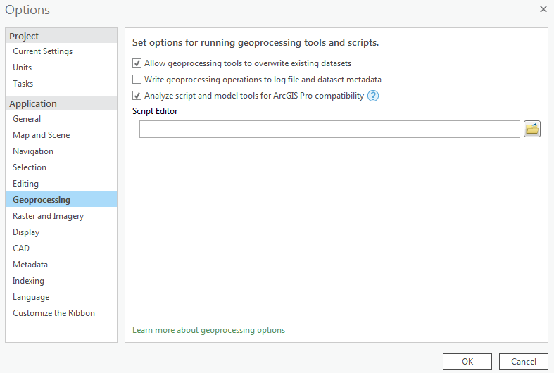

These are the geoprocessing options that I found in my project:

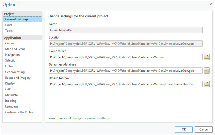

...and these are my project settings (no spaces in paths):
I'm not using any tools in ArcToolbox in the project, although I am using some geoprocessing tools, but don't see anything in the environments of those that would affect saving the project.

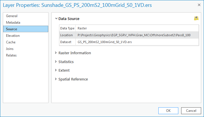

The properties of the sunshade raster function I am using are interesting, they state the as the input layer as the data source:
...this suggests it is generating the sunshade on-the-fly and not creating or storing a temporary layer at all?  As far as I can tell, everything is stored locally, within the ArcGISPro project, or within a folder structure at the same level as the Home Folder.
