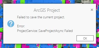

I've been working on a project in ArcGIS Pro 1.2 today. After a day of successfully being able to save my project, I am now unable to do so. Each time I try to save I am given the following error ProjectService::SaveProjectAsync Failed.

Following each of these measures I have reopened ArcGIS Pro, panned the map a little and then tried to save. Each time, I have received the above error message.
