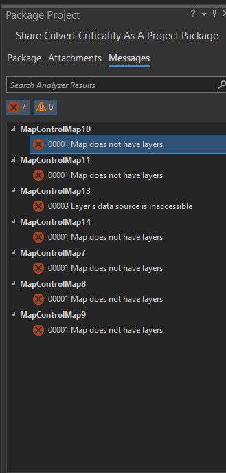

I'm trying to share an ArcGIS Pro project by exporting it to project package using the New Project Package -> save project as file tool from the Share Tab.
When I do this I get several errors saying MapControlMapXX does not have any layers.
I can click on the Options button for each and open in the Contents Pane. These are all blank maps. I do not know how they were created and I cannot figure out how to delete them. I don't see them listed in my project folder in File Explorer.
How do I get rid of them so I can create my Project Package?

Thank yo for your response. In my original post, I should have stated that I cannot find those maps listed in my Catalog Pane. They are not listed under Maps or any other folders associated with the project as best as I can tell.

Thanks for the screenshot. That's odd. I'm not sure where the maps are. It may be best to contact technical support so that they can take a closer look.

Hi, I have the same error with ArcGIS Pro 2.6.3. I imported this project to Pro from mxd earlier. I created list of maps in notebook and I see many deleted earlier maps whith layers also  but invisible  in Catalog now.
