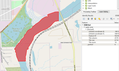

Otherwise, though, your vector tiles are devoid of any of the source data. And it's worth noting that Esri publishes vector tiles at a deprecated version of the Mapbox vector tile style spec, and when it packages your features, it's not retaining your attributes as key/value pairs. Symbology styles are stored as "_symbol", not as the attribute/expression, and no actual value, just a number.

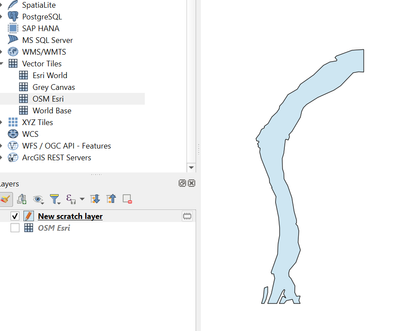

Now, to your other question: can someone with know-how "hack" the data out? Kinda sorta, but again, they'll only be able to see the data you're loading into the tiles. Here's me loading a vector tile layer in QGIS and looking at a specific feature.
I can select, copy, and paste features from the tiles. But given that the tiles have cutlines, and the scale at which I copy the feature will completely change what I get. The short version is that getting useful data out of vector tiles would be a lot of work, and most likely is not worth the effort.
