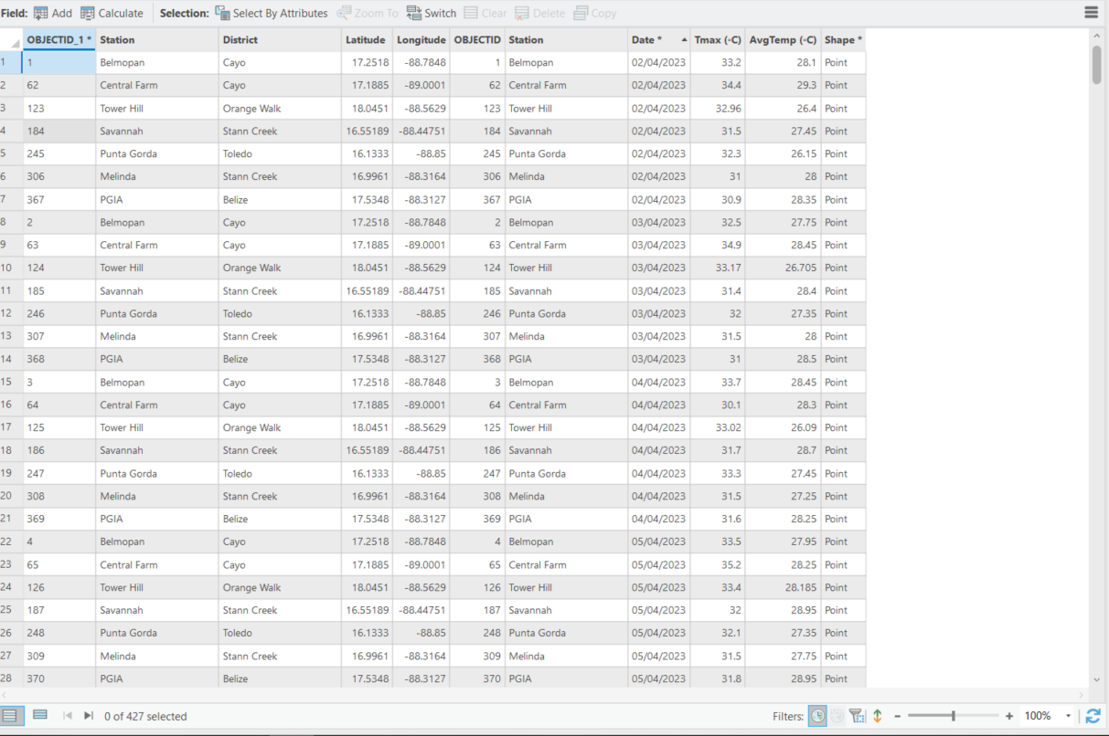

I have a feature point layer that is time-enabled. it contains data on weather stations and the recorded Maximum Temperature and Average Temperature from each weather station on a single day ranging from April 2nd to June 1st.
Now this point layer is time-enabled because there is a different temperature reading on each day recorded on each weather station.

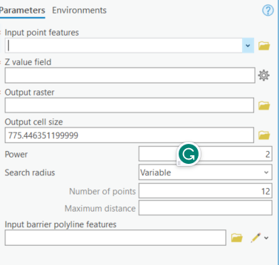

I want to do an interpolation (Kriging and IDW) on this point layer, I understand that I can just go to the toolbox and input the layer and Z value field I want.
But I'm wondering if I can time-enable the point feature layer due to it having a date field, Can I time-enable the IDW and Kriging layer I created from that same point feature I inputted?

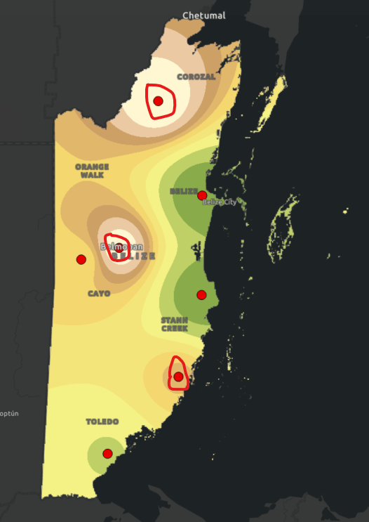

So, for example, if it shows the following dots, I circled red had the highest temperatures.
Could I time-enable it so that when I slide the time slider the IDW and Kriging output changes based on the recorded temperature on each station by that particular day?

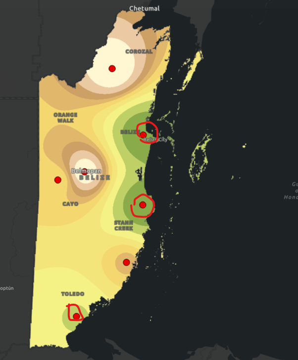

So, when I slide the slider after a few days the highest temperature on a particular day can change from the previous screenshot to the screenshot below for example.
Is it possible to do that?
