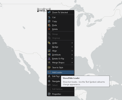

CraigWilliams
Leader lines are supported for text graphics. Add/remove them via the context menu. The text symbol callout settings can be updated to change the appearance:
DavidWheelock2
Thanks @CraigWilliams.  Is there a way to add a leader line to other graphic objects, such as an image or a drawing?
