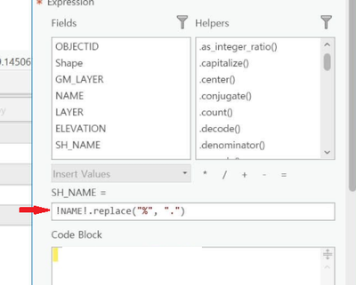

Hi
What is wrong?
What should I do?
Thank you~~

You need to put the expression under "SH_NAME=" box, not in the code block.

KalSsin
oh~~~thank you so much
