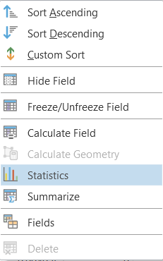

Have you checked Statistics (Attribute Table > Right-click Field > Statistics).

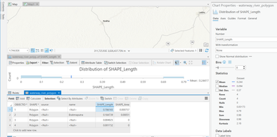

The Statistics button that was mentioned by @JayantaPoddar is definitely another option that is possible in ArcGIS Pro. This opens a chart of the field, and in the Chart Properties pane, several statistics are shown.

This seem to apply in ArcGIS Desktop and not ArcGIS Pro.
JayantaPoddar
MVP Alum
The screenshot, I shared, is from ArcGIS Pro.
