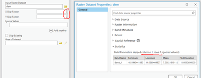

I've tried changing inputs to the GP tool to get ANY kind of change to the outputs.  In fact the 'metadata' listed on the raster properties never updates either.  Example, below.  I used skip factor 2,2.  No change to the stats.  'Build Parameters' info doesn't show a change either.
