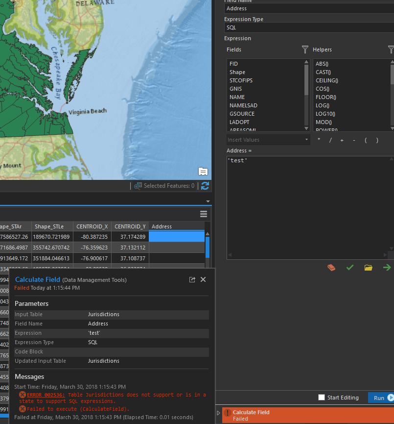

I get this error:
ERROR002536 Table Jurisdictions does not support or is in a state to support SQL Expressions

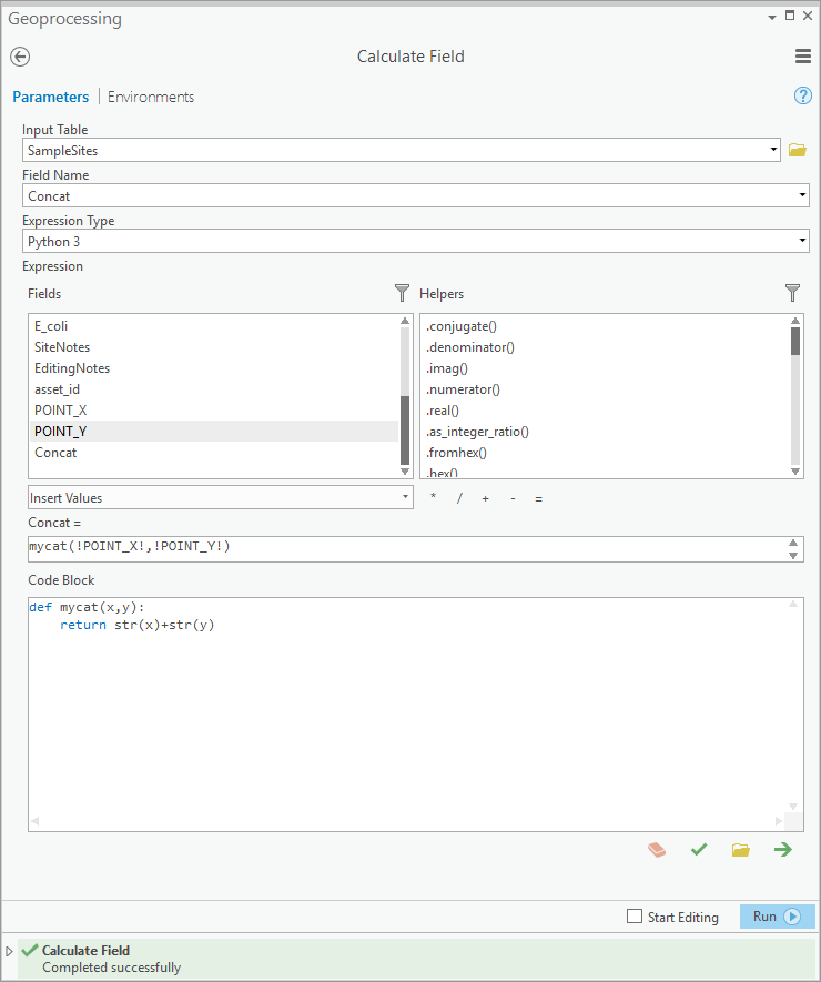

I got this simple Python def() to work in Pro:
That should just about do it....

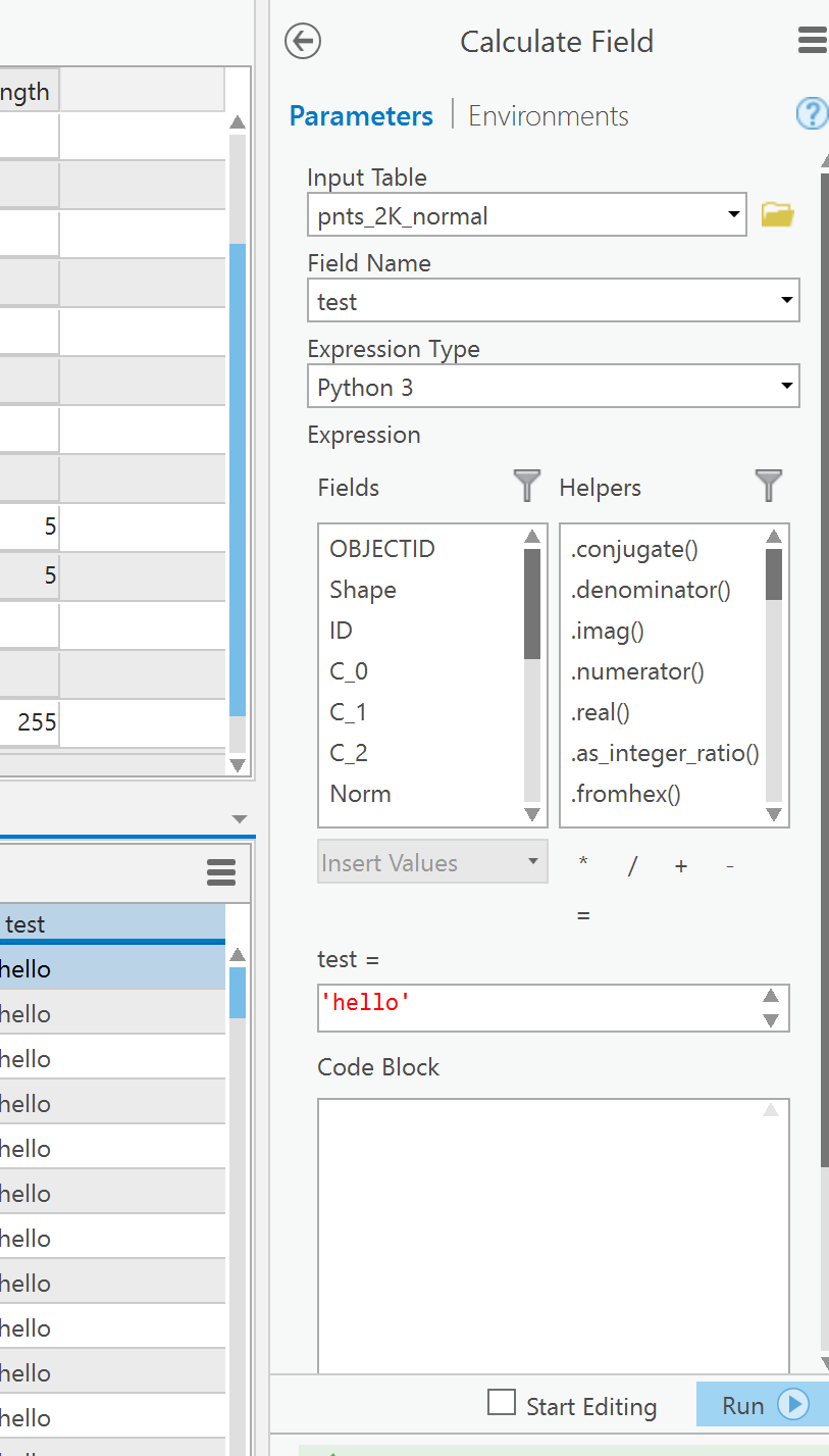

python parser
X and Y , two fields
x = 10
y = 20
"{} {}".format(x, y)
'10 20'‍‍‍‍‍‍
you would therefore use !YourField! for each of the x and y values.

Somethin such as the below is failing
FieldName =
'TestingValue'
FieldName=
"TestingValue"

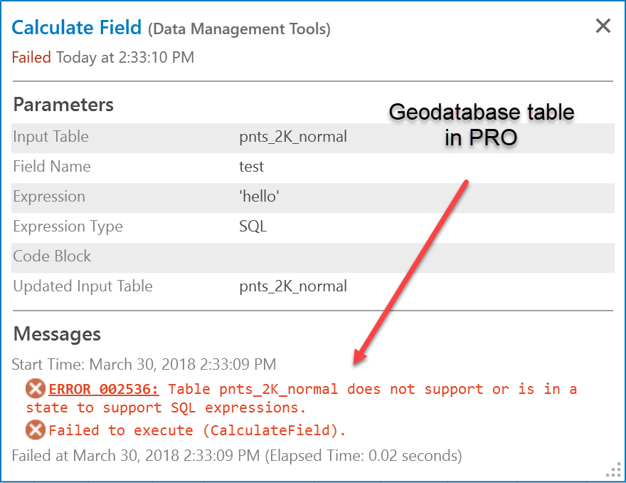

You said that you get
That's the error in Pro?  Can you send a screenshot?  What database are you working with (file, Oracle, SQL server, etc.?) and version?

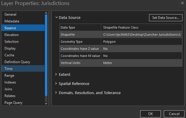

This is ArcGIS Pro 2.1.2
I am simply hitting a shapefile - I havent tried on a GDB or SDE FC

I was able to get it working in Python3

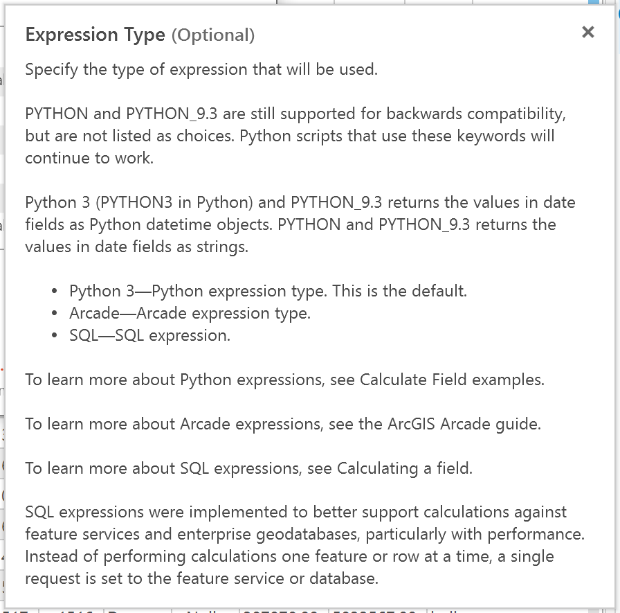

shapefiles (yours) and geodatabase tables (mine) apparently don't support unless you 'do' something.
Maybe yours and mine is obviously not an sql thing.  I never use sql, I had erroneously assumed that yours was a valid sql thing.
Which... according to the help are
