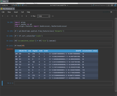

Amir-Sarrafzadeh-Arasi
Dear itayroei,
I hope you are doing well,
If you are using ArcGIS Pro, you can do by this way, insert a New Notebook,
and write the python script like below image,
Here I read the Airports feature layer as a Pandas DataFrame, you should put your feature layer's name.
Then I have sorted by scale value, which you should put the name of the column which you want to sort the dataframe, and then create a new column which is accumaled values of size column which you should put yours.
If need more info please let me know.
Hope it works,
Best Wishes
Amir Sarrafzadeh Arasi
