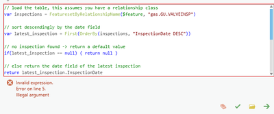

It's advising there's an error on line 5:

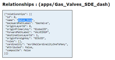

Do you actually have a relationship class between your feature class and the inspection table? Is it named "gas.GU.VALVEINSP"?
Have a great day!
Johannes
JasonCyphers

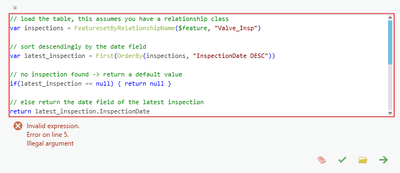

Oops...no.  But, I did change to the correct name, but it still gives the same error:
