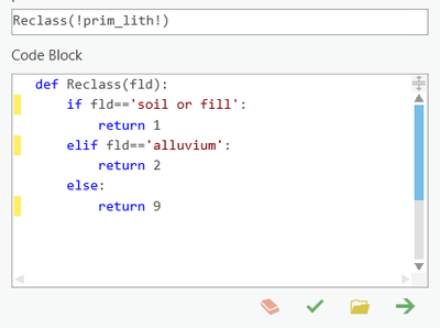

Hello, in PRO I am trying to use Python / Code Block to use existing field !prim_lith! (text field, with geologic material descriptions, eg, clay, sand) to populate a new field !prim_lith_reclass! (short integer field) whose value 1, 2, 3,...9 depends on the geologic material in !prim_lith!.  The Expression is valid and runs but the return values are all equal to 1 (from line 3 in the code block), see lower right of attached jpg. I've tried varied syntax etc. but nothing seems to work.  Should text be in double quotes "text", or double apostrophe 'text' ?  What is the difference between !=  and == ?  Do I have to explicitly enter an Else?
Any insights would be greatly appreciated. Thank you!

!= means "not equal to"
== means "equal to"
I think you have put != instead of == ?
Please replace != with ==

please format your code, you're also not showing the entire code block.  It makes it very tedious to try and help you Code formatting ... the Community Version - Esri Community
Can't even see line 42 of your code.
I would add an else at the end to take into account misspellings etc. set it as something like 999,-999 or whatever.
else:
  a = 999
return a

Ensure that you have returned variable a with appropriate indentation.
Could you check with a code-block similar to the following
def Reclass(fld):
    if fld=='soil or fill':
        return 1
    elif fld=='alluvium':
        return 2
    else:
        return 9

Thank you, that makes sense. I replaced as suggest and the expression is still valid but now get a run error 000539 (attached).

Okay I apologize for that. I couldn't fit the vertical extent of the code block into Snip so I've attached the top and bottom halves.
In any case, I incorporated your ideas and the code now works!  Thank you for the insights!
