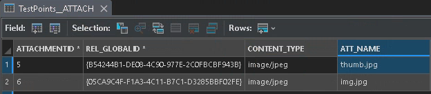

For the Calculate Field tool with Arcade:
var related = First(FeaturesetByRelationshipName($feature, "TestPoints__ATTACHREL"))
if(related == null) { return $feature.ATT_NAME }
return related.OBJECTID + ".jpg"
Before:
After:
