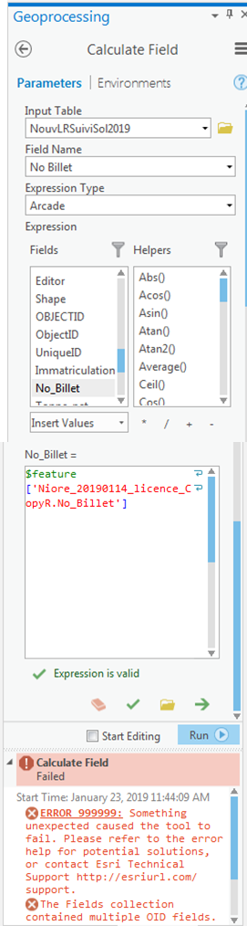

In ArcGIS Pro, I have a hosted feature layer (produced from Survey123 Connect) and a standalone table from a local FGDB. I performed a join in order to update a field on the feature layer from data contained in the table. Performing the calculate, using Arcade, I get an error message about multiple OID

I would log this error at support, since I think this should be able without generating any error. At the same time I think you should be able to do this calculation in ArcGIS Online directly, possibly applying the FeatureSetBy* functions access the table in the Arcade expression.

Hi - I am managing a hosted feature service in ArcPro.  To update a text field, I joined an excel table that has updated info.  Then I was going to use calculate field to replace the existing data but the process failed.

I am not a big fan of joining data directly to an Excel file (or using Excel data directly). I assume that Arcade will be able to access the data from the Excel (I have not tested this) and update the hosted feature service based on values from the Excel file. Is it possible to obtain access to a sample of the data?

Try using expression type = python 3.  Worked for me when joining a csv. ArcGIS Pro v2.6
