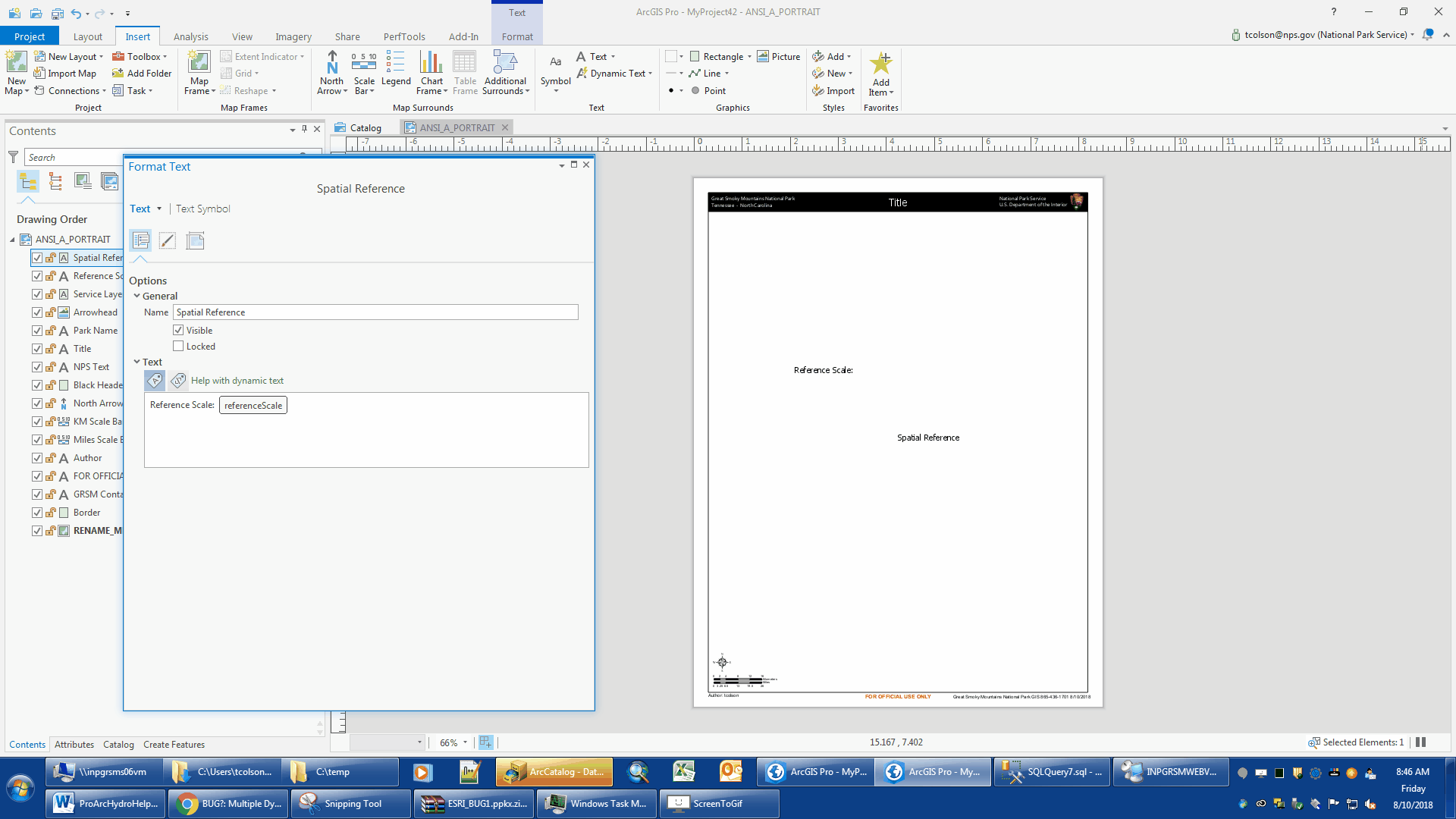

I have seen similar behavior in 2.2.1 when I was converting our existing Arc Map Templates to Pro Layout Styles, and thought it was a byproduct of my hatred of making layouts. I will work with Kevin on getting a reproducible case submitted, as this seems to happen to a few folks.
The workaround is to take focus off the dyn text element to another element, then back to the dyn text element.
