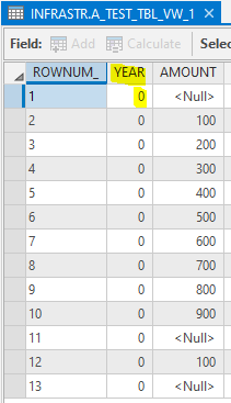

When I add the view to ArcGIS Pro 2.6.8, the YEAR column is displayed as zeros, which is incorrect:

Why is the YEAR column being displayed as zeros in ArcGIS Pro?
I'm aware that views can be tricky in ArcGIS, especially when there are generated rows — rows that aren't selected directly from a table.
But I believe I've satisfied all of ArcGIS' requirements for views. The view has a unique ID that is a number. And the YEAR column has been CAST as a proper integer too. So I think it should work. And the fact that it does work in ArcMap tells me that it should work in ArcGIS Pro too.

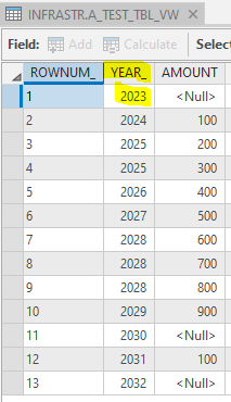

The problem seems to be the column name "YEAR".
If I change that column name to something else, such as "YEAR_", then it works fine in ArcGIS Pro:

"YEAR" is an SQL keyword in Oracle (but using it in SQL isn't prohibited, just discouraged). Maybe that causes a problem in ArcGIS Pro? Or maybe "YEAR" is a reserve word in Pro, but not in ArcMap?
