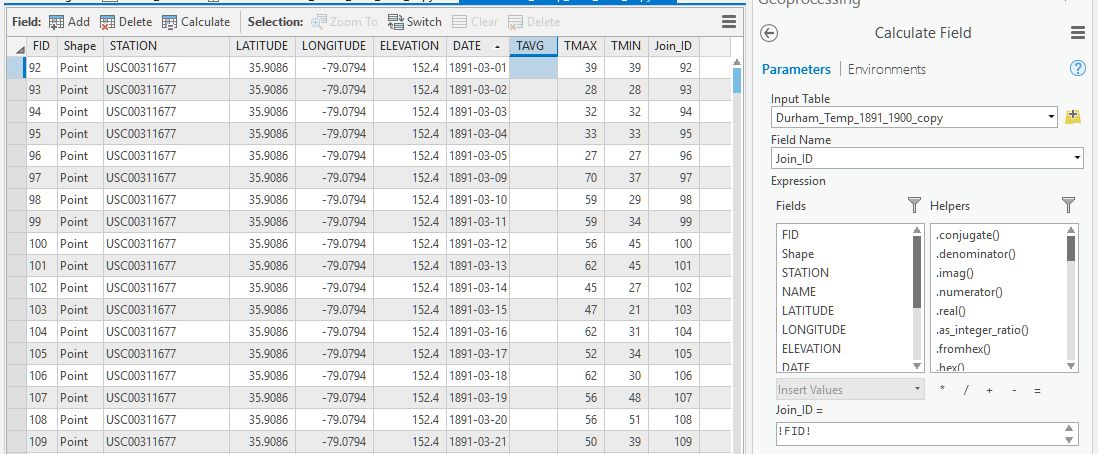

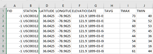

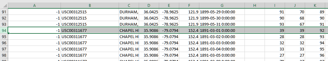

I have had the exact same issue, only I am not selecting individual rows for export. When I Rt-Click my point feature in the ToC --> Data --> Export Table  ... I get this "-1" in the FID field in Excel.
To get around this I added a "Join_ID" and calculated the values for the FID before exporting to .csv. This seems unnecessary, but it is the only way around the problem that I have found.
