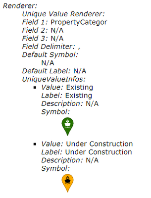

We have point feature service added in the webmap and the service has following drawing info:
The layer symbol saved when we created the webmap with following :
"uniqueValueInfos": [
                                        "symbol": {
                                            "type": "esriPMS",
                                            "url": "9dca2f6e1fdfd94c27ae0bde34527bdf",
                                            "imageData": "iVBORw0KGgoAAAANSUhEUgAAAB4AAAAvCAYAAAD0FnqqAAAACXBIWXMAAA7EAAAOxAGVKw4bAAAERUlEQVRYhe2YwW7aSACGP9skFG1lKVKChOXsA5DcvAeuXHIitwJ5AmcPjdQXqEJ2H6F7wYc9F1L1sPSUw3LNIb41PECKQKUrVbGSJgVs78GYQBgbSLLaw+4vIeQxM9/8M/PPjEjwLynxP3hRbe6hAXx6S+cfBWsldmUwgAJg+F5QrpcAny4yDdnDujjGfhKwXsREwpQUDCUFiR+Ccnk1+PZd8Ppk3FtM9wZTL2HLPvvzOhAL1stUJRlTScHqmvg3kgJKKviwBsMrjP5XzvQyVrvG/lLgzT0036Uqr1BYXbtzt4gSz4NO3H7G1EsY7To/LQz2XapykkJyPXAkUj67C0Cz1Zh5JymQ0uD2M4ZepipyPgPWi5hyMnAaBT3YqZDPFgDY1g3enFSEv0uuj5wXsdvHWJHg0RBXVtT44c1nC3xs23xxuuSzhUiwpARr4/sXKhAD9l0KcpKMkoqGHuxU2NINPrZtNtQMW7rBwU4lEq6kQE6S0YuYk66nh1oKVnCU0qrGy53D8fO2bgDwcueQ2qlFzxHvJatrwZCDAPxjEcMDQ3kWDd7SDWqnFrVTi/O2PS7b1g3y2QK1U0tYbzRtxuYeWrjTjcFDCU1R4ue22WrQbDUo50x+fVEF4PW7/UjgpCQFXBcD7oFln0wcNHRWzplsjYYY4P2rM3pOl2arwW8nR5HDLa+C/41M+Hw3xxKa785WSKsav7yojuMjUlrNUM6ZlHMmtVNL2AHfDRgzYA9sWdBoz+mQVjOCN2Jt60aka4+7/XsMTvh0vL64sdfv9nn/6mwh8JuTo5my0UFCwr87Qsfgi2NsvUh3eEUm8Xy64nnbpud05zoP5/q+3BsA7MkTazrHMo3hNeZ9MDBezXESQQHcW0CaPianwLKH5fUxvf5srM7bNs3WB9Jqhg1VG7vvOV3O2zZpNTPO9qS8fuBY9mO2zItjbL2MNXAwk+vTDYQbR6hyzowc2kkNHEDCuqjHOAaQJI7cm2nXaVUjny2QVjU21MxUJ/LZXbZ1Y1w+6drrg/uNrnzvgBCCP72lo5c4+v4Xhyntzh3An60GaVWjnDNHsenSczrUTi3Sqsb26MD4+ffgrO5/BWQaF7XZa5DwItCuU9GLmOEKnzx5zrFpthrj3St0eD5qOxyJ4RV4fex2XXz9ibxzeRL7A4c/RCt8EiiS78LwGjyYDfU8cKdOQy9hDxyMFTWSIdTwOnDbqRO58mJvmbLP/uCSM+XZ4hc+rw+Dy3i3c8Fx8YpSGJ9OLdrtXDCI4xWluPgsDRbFK0px8VkaDLPxEmlefB4Ehvh4LRKfB4Pj4rVIfB4MBnG8Fo3Po8AXx9h6Cdu9xQjB7i3g86FzvLjbpcFw53pFDeZ2cAmeND8+jwaHrodXhHfcpeb2wWAYuXY4k5Tl5/ZR4JFr/CHdZef2UWAAJCykB9d+OFj2ll9QTwJe9G+lJwc/Vv898N+msfrP1ky4LAAAAABJRU5ErkJggg==",
                                            "contentType": "image/png",
                                            "width": 22,
                                            "height": 35,
                                            "angle": 0,
                                            "xoffset": 0,
                                            "yoffset": 0
                                        "value": "Existing",
                                        "label": "Existing"
