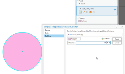

In ArcGIS Pro you can create a Group Template, which is a special kind of feature template for editing, that can be set up to create multiple features at once, including a buffer polygons around a point.
https://pro.arcgis.com/en/pro-app/latest/help/editing/introduction-to-feature-templates.htm#ESRI_SEC...
