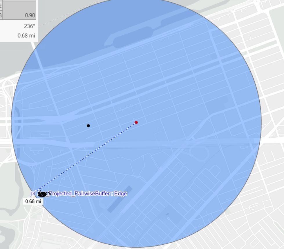

Hello,
I am using ArcGIS version 3.3 and have encountered an issue. I created a 0.5-mile buffer around a point, but when I use the "Measure Distance" tool to check the distance, it shows 0.68 miles. My layer is projected in State Plane NAD1983 FIPS 2001. Could you please advise on how to resolve this discrepancy? Any assistance would be greatly appreciated.
Best,
Yesim

DanPatterson
MVP Esteemed Contributor
open a new map, without any basemap
add the buffer layer and only that layer to the map
the map coordinate system should match your featureclass
add the point featureclass to the map and measure the distance now
do you still get the 0.68 mi buffer?
if so, buffer the point again within that map and report what you get
measure the buffer

YesimSungu-Eryilmaz
Thank you! I changed the map's coordinate system to State plane as it was set to WGS84 and that solved the problem.
ChristopherCounsell
MVP Frequent Contributor
When running the buffer tool it will respect the output coordinate system and any transformations.
https://pro.arcgis.com/en/pro-app/latest/tool-reference/analysis/buffer.htm#GUID-E3EA0491-1E80-418B-...
This means that the buffer may run and generate in the desired coordinate system (0.5 miles).
But the map may be measuring in the map coordinate system e.g. WGS84 web mercator would throw a different measurement.
As Dan Patterson hinted at, adding the layer to a new map will default to the layer's coordinate system and show the measurements in that.
But one other thing to consider is that you can do planar or geodesic buffers. By default the planar method will be used. Double check what mode is being used in your map when using the measure tool.
https://pro.arcgis.com/en/pro-app/latest/help/mapping/navigation/measure.htm#ESRI_SECTION1_AA3FBCB33...
