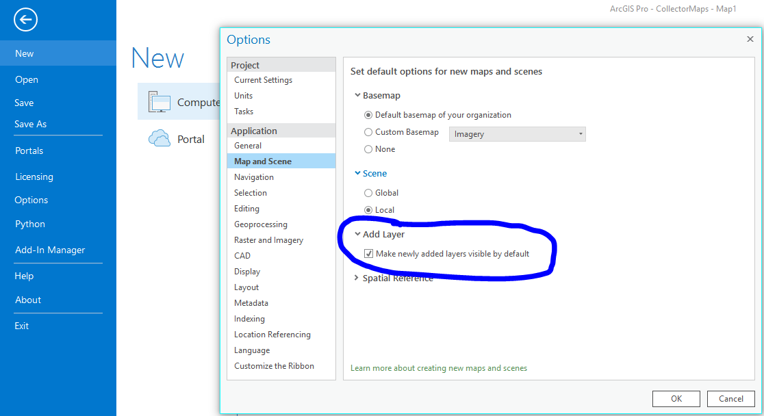

Hi Mike - Here's what you're looking for I believe. Under Project --> Options --> Map and Scene

Thanks for the quick reply as that was exactly what I was looking for.
