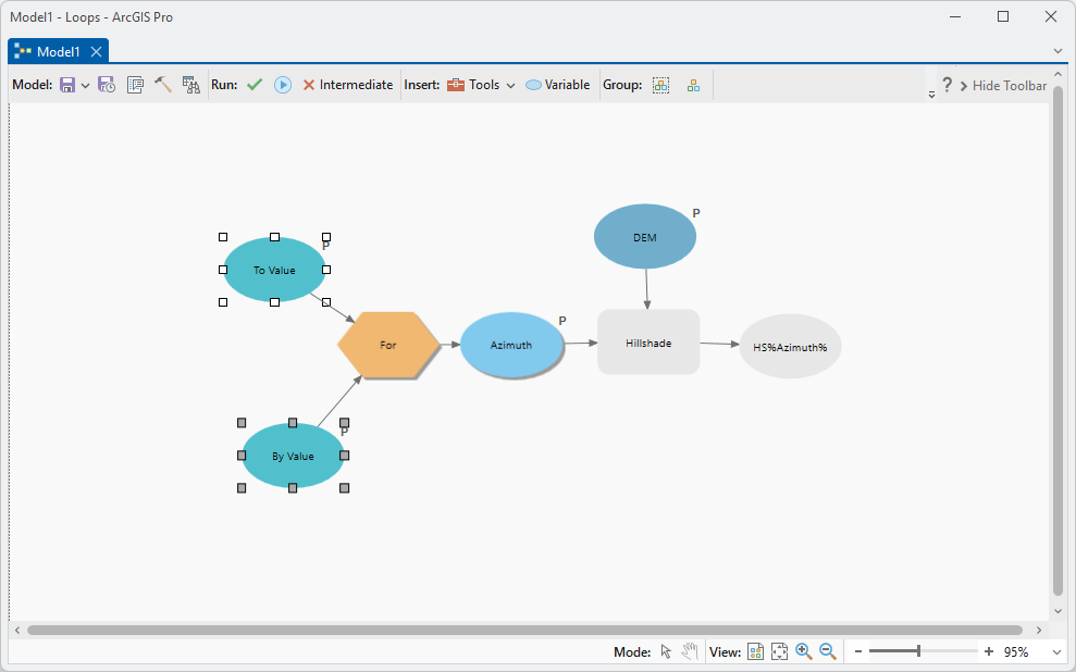

I am trying to use the modelbuilder to average multiple hillshades. At the moment I am having problems with just generating multiple hillshades. Here is the model I have so far,
More generic question:
If I wanted to aggregate multiple rasters that I the model builder is creating in the fly (think adding n number of rasters that are generated with each iteration) what is the recommended way to do this using model builder?
Thanks

I wanted to change both orientation and elevation (but I just started with the former).
Thanks I was aware of the function but still wanted to reproduce the process as a way to focus on the more generic question I posted.

When adding multiple rasters, look into using the Cell  Statistics GP tool  https://pro.arcgis.com/en/pro-app/3.4/tool-reference/image-analyst/cell-statistics.htm.
You can calculate mean, median, standard deviation, etc.
