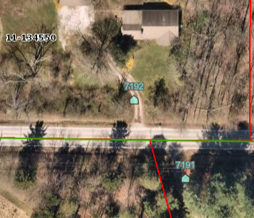

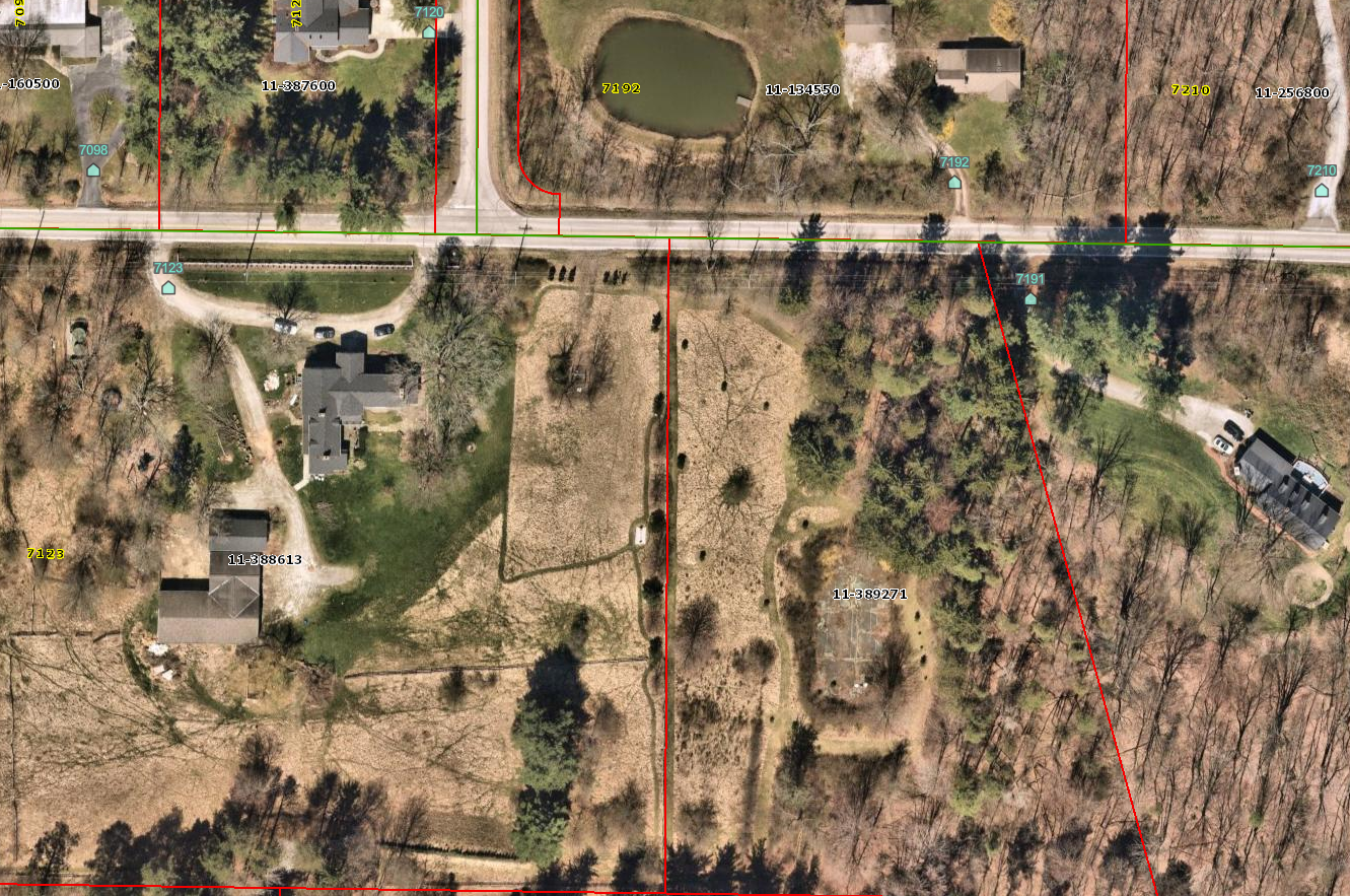

I have this layer filled with thousands of land parcels in a polygon layer, and addresses in a point layer. I need to find a away to automatically fill the empty spaces in the land parcels with an address number and address name, and add a point to the address layer. I don't if there's a tool for this, and have little experience in coding. The formula suggested to me:
 (b) the difference between addresses divided by (a) Distance Between Existing Addresses multiplied by (c) new address distance plus the smaller address number|(((b2-b1)/a)*c)+b1
Below is an example of an area that needs addressing. The address for this one should be 7151

from the points and polygons both have address numbers, what I'm trying to do is fill in the blanks. The parcels with no address are new properties that require new addresses, such as this middle parcel I used as an example for the equation.

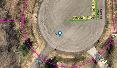

You can use Reverse Geocode tool in Pro to do it.  A key factor with 911 addresses is that the point the address is based on should be where the driveway leaves the road, just like in your image.
ThomasGoodridge
I tried reverse geocoding, it doesn't seem to be keeping in sequence with the other addresses
