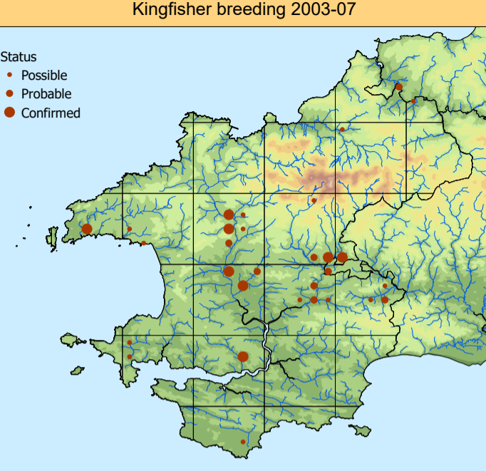

The final map for each species should look something like the one below. The exact same template and extent will be used each time. In the example below I have applied a definition query on my bird observation layer (Species = 'Kingfisher') and applied a Graduated Symbols symbology to the breeding status.
I want to create a layout with the same template and extent showing the corresponding information for each species. There are 133 species and 3 survey periods - I really don't want to have change a definition query and species name in the text box almost 400 times! I figured this should be reasonably straightforward to automate in ArcGIS Pro, as it seems to me like it should be a fairly routine task for GIS users to have to create multiple maps of the same extent showing different features, or different values of a field in a feature class. So I was surprised to find that the Map Series functionality can only be defined by spatial extent, unless I'm missing something.
