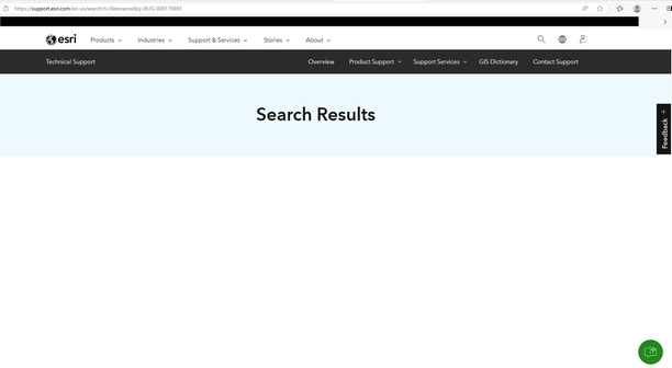

Edit: I just remembered I tried searching a publicly available bug number earlier to see if it worked, and it seems to just go to a blank "search results" page. Have you tried this recently? Maybe the site is malfunctioning?
Melissa_B
Public bugs can be searched by number on https://support.esri.com/en-us/search
Not all bugs are on the public list though; I think they have to be reviewed first, but I am also not super clear on what gets a bug or enhancement moved to the public list.
