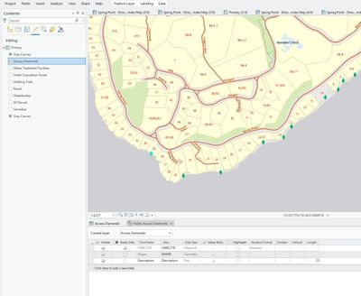

Longtime Arc GIS user, absolute newb using GIS Pro. Imported existing v10x project, created new point feature class, added 12 points via mouse/cursor, added description field in table. When I tried to edit the points the attribute table and ribbon above it started flashing, and I cannot edit it at all.

If you go to the List by Editing view in the Contents Pane (left side of the UI), do you see a red exclamation point indicating broken data links?  If so, either remove those layers from the Contents Pane or fix the broken links to the data source.
DavidMeek1
Robert, no such luck.
