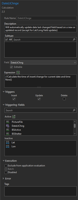

I have an attribute rule set to calculate the current date/time in a field named "DateLtChng", triggering on Insert and Update. I have this rule set to trigger on all field updates EXCEPT Lat & Lon (noted in Inactive triggering fields list).

Imaged attached of how my rule is set up for reference. I am on ArcGIS Pro 3.5. My Lat/Lon fields are set to the "Double" Data type.

So in your screen grab, you have the "editable" box checked.  In the help documentation, it says:
Checked—User-defined attribute edits are permitted on a field. User input for this field can be overwritten by evaluation of an attribute rule based on the rule definition.
Unchecked—User-defined attribute edits are not permitted, and the attribute field the rule is created on is defined as a system-maintained field. The calculation rule will be applied during the triggering event defined in the rule.
What I'm wondering if you uncheck the box, then user-defined edits, such as the user typing in an attribute value, is not allowed and won't be triggered.  If I'm understanding the documentation correctly.  What occurs if you uncheck the box?

Unfortunately, this looks like it just keeps users from inputting their manual changes to the "DateLtChng" field (you can see the greyed-out field below).
I tested again manually changing the Lat/Lon fields and it seems to still update this DateLtChng field automatically, even with checking the "Enable Editing" function off.
