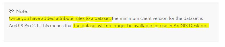

I am also looking for guidance and documentation for adding Attribute Rules to a dataset. As stated by @Michael Kolz, the limitation/restrictions associated with Attribute Rules are a definite deterrent to migrating to ArcGIS Pro.
Add Attribute Rule—Data Management toolbox | ArcGIS Desktop
Note:
Once you have added attribute rules to a dataset, the minimum client version for the dataset is ArcGIS Pro 2.1. This means that the dataset will no longer be available for use in ArcGIS Desktop.
Attribute Rules, ArcGIS Pro, no longer available for use in ArcGIS Desktop
