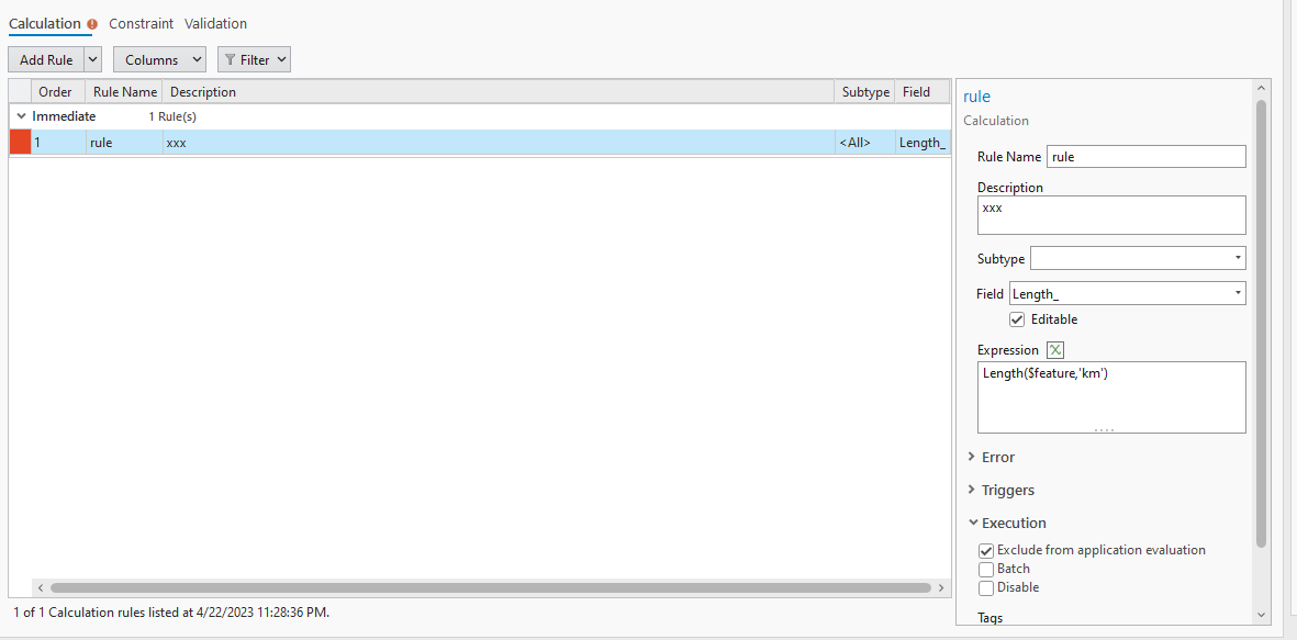

Hello,
I created a immediate calculation rule to calculate the length of polyline when the insert/update action occurred. I made sure I checked syntax when enter the Arcade codes, but when I tried to save rule, the rule row turned red without telling what's wrong.
Does anyone have idea what's wrong with this rule? The targeted field "Length_" has data type of "float". The polyline feature class uses WGS1984 (WKID 4326) and probably because of that, the default shape_length return incorrect shape length numbers. That's why I decided to set up a new column. I tried to use field calculator just to make sure calculate geometry worked under this spatial reference.

If you hover over the red square, it should tell you what's wrong.
Common reasons you can't save a rule:
  • You forgot to add GlobalIDs to the feature class
  • You forgot to set a trigger event
  • Error in your script
  • You're editing the feature class (though that will deactivate the save button, not show the red square)

Thanks. I didn't realize that's the way to find error message. Global ID was the issue for my case.
