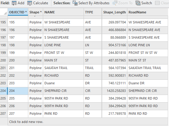

Hello!
I need some assistance with how to edit a few attributes. I did a calculate field process that worked, but it duplicated some of my values in the process. I am editing some data in relation to streets and street types, so some of my values now have duplicated street type information. What are a few ways I can go about editing this? I am working on this through ArcGIS Pro.
Thanks!

Looks like your field calculator was something like NAME + " " + TYPE? You'll notice that 905th Park Rd for example already has Rd in the NAME field, so when you tacked on TYPE, you got two "Rd"s. Depending on how big your dataset is, you might want to sort through and remove those. You could do a Select By Attribute NAME LIKE '%RD' which will highlight all instances where there is text where the last two characters are RD. Then just change for all your different street types.

If you did NAME + " " + TYPE to calculate the RoadName field, you need to clean up your NAME field first.  I'd recommend using the arcade Replace function or the .replace python method. You could replace " RD", " AVE", " TRAIL", " CIR", etc. with "", to remove all the types from the name field.. since the type is already in the type field.  Making sure to include the space before the road type.
Then you can do NAME + " " + TYPE
