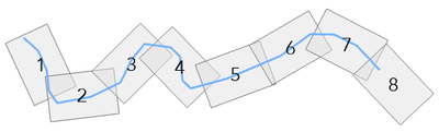

Start with a strip map series such as this:

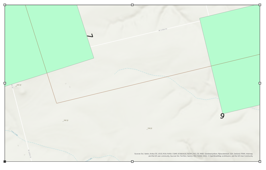

A sample map series page may look like this:
