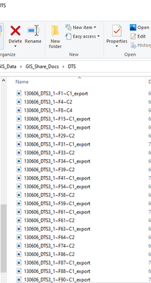

I have a set of jpg and need to create a table to then attach each individual pictures to a  point in features class. Any ideas on how to do this task

I believe you want to generate a match table, then feed that into the add attachments GP tool.
If you don't have a field that will let the tool find matches, you can create a match table yourself and use that.
See note at the bottom of Example 1.

Thanks! This was super helpful. I appreciated it.
