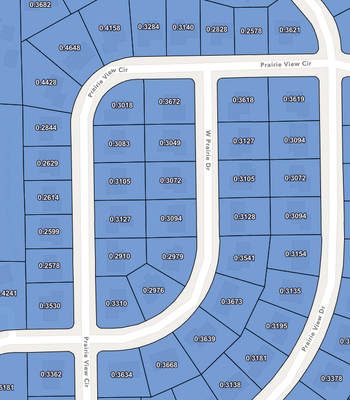

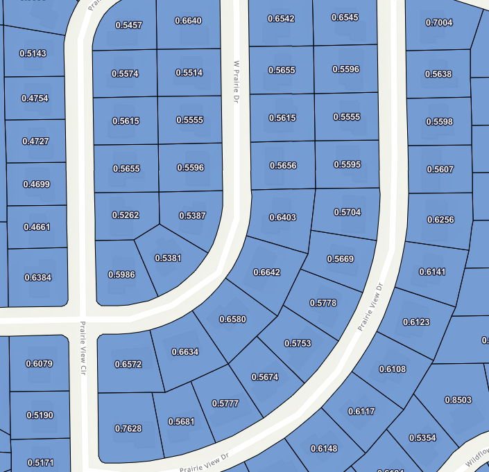

Can someone explain to me how to get consistent area results from a hosted feature layer?  Below is an example from one of our polygon hosted feature layers.
If I bring a hosted feature layer into Pro and use the Arcade area function or manually calculate the area (which should be sq meters because the hosted feature layer is using Web Mercator) to acres, I get an incorrect value when the map is in Web Mercator.

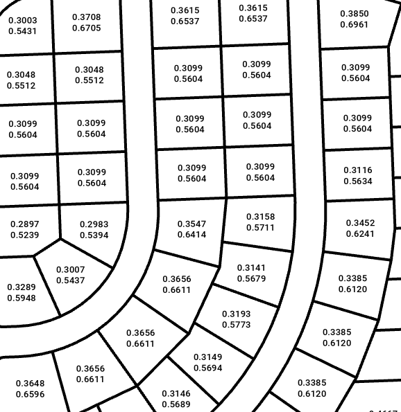

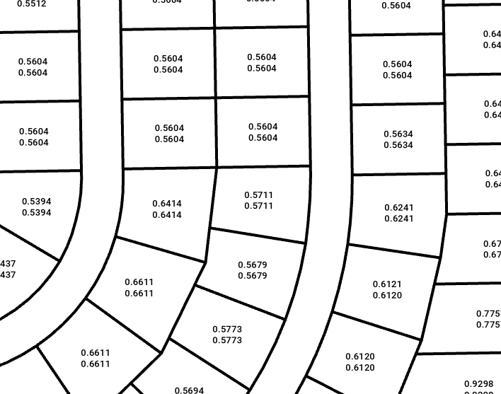

If I change the coordinate system of the map to State Plane, which is the coordinate system of the source geometry, the Arcade function returns the expected area value, but the manual conversion is still way off, see screenshots below.
Label expression being used in all screenshots
Arcade function and manual calculation are incorrect when map is in Web Mercator.
If I change the map to State Plane, the Arcade area function is now showing the expected results, while the manual sq meter to acres calculation is still way off.
