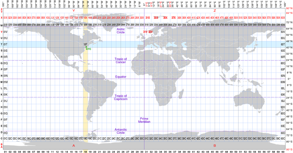

The UTM coordinates vs UTM projection question.
They are tied together because the X and Y values are the same, the N vs T is the lune vs utm zone thing, that is why there is no 17N or 17S  when eutm.pngxpressing coordinates as UTM coordinates, but there is a 17N and 17S when talking about a UTM projection (north and south of the equator)

17 N  means zone 17 North of the equator
17 T   is the lettered 6 x 8 degree block within the zone from 40-48N  latitude 78-84W longitude
Universal Transverse Mercator coordinate system - Wikipedia
 Universal Transverse Mercator zones - Universal Transverse Mercator coordinate system - Wikipedia

I understand what you said here:
But my question is more: Why do the UTM units at the bottom of the map view use 17T, when the Project's Map/FC uses 17N? Is it because the UTM map units at the bottom of the map view are not tied to the Project's Map projection?

no https://en.wikipedia.org/wiki/Lune_(geometry) it is the area bounded by 2 lines of longitude eg between -78 and -72 , 6 degrees of longitude in width, the width is 6/360 of the circumference of Earth at the equator and 0/360 at the poles.... think of the outer surface of an orange section
