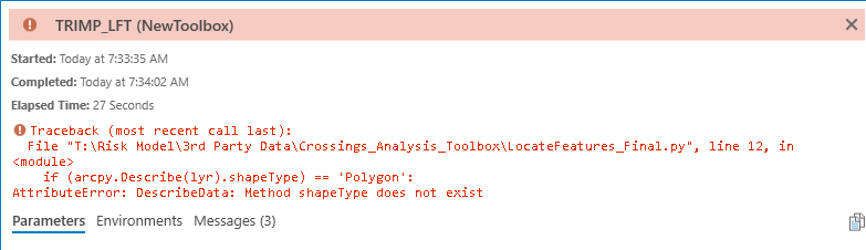

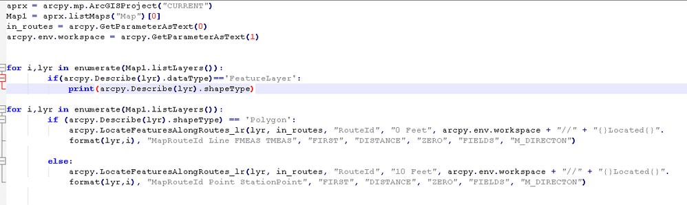

my script is returning an error that I dont understand. (see image below)
code snippet:

Your layer object has things in it that are not shape, so it's choking on that. It might be a group or a table?
To debug your error, start by looking up Describe in the docs to see how it's used.
https://pro.arcgis.com/en/pro-app/latest/arcpy/functions/describe.htm
Look at what it returns, it's just an object. That object can then have properties and methods.  So in theory your syntax could work if Describe returns an object with the property "shapeType" but it's not.
Look at what it's returning in that docs page, it will be an object of type "Describe".
It can return any of about 30 different things. If it's not returning a feature object it won't have a shape. Also it could be returning a NULL. You might want to use a try / except block to handle those cases.

The error message is a little confusing because Python thinks shapeType is a method, it would really be a property. But whatever, there is no shapeType defined on whatever object being returned by Describe for that input.

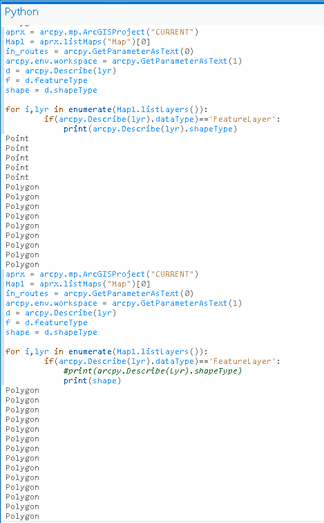

Thank you for your input. I added some of your text to my script and ran it in the python window.  As you can see the print(arcpy.Describe(lyr).shapeType returns the point layers (sourced from my company portal) and the Polygons (all fgdb feature classes from separate fgdbs).  When I print(shape) I only get the polygon layers in my map.  Here is a snippet from my python window

Okay, when you look at FeatureLayers only, they all have a shapeType --- that's what I would expect. In your first example you did something like this, this will probably fail --
aprx = arcpy.mp.ArcGISProject("CURRENT")
mp = aprx.listMaps()[0]
for lyr in mp.listLayers():
  d = arcpy.Describe(lyr)
  print(d.shapeType)
In the second one you did something more like this,
  if d.dataType == "FeatureLayer":
    print(d.shapeType)

I appreciate the help.  I actually got the tool to run through successfully yesterday. Oddly, no error was received.  I am trying to get a license for Microsoft Visual through my company's SOP.  So, that will likely take some time.
