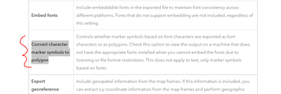

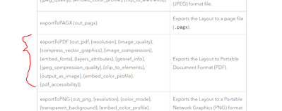

I'm no seeing the "Convert character marker symbols to polygon" parameter in the exportToPDF method.  Guessing I might have to dig into CIM unless I'm missing something.  Any thoughts?  Tyler

@TylerT I don't think so.  Think of the CIM as a way of setting properties, not methods.  We have plans for 3.2 to add this capability (and other updates) to our export functions.

Interesting. So the ArcMap command - ExportToPDF- using Python 2.7 has the convert_markers parameter while ArcGIS Pro 3.0.2 using Python 3.9.11 does not have the convert_markers parameter.  Not sure why...
BUT ArcGIS Notebook Server in ArcGIS Enterprise DOES have the convert_markers parameter...strange...
JeffBarrette
Thanks for the feedback.  This is something we have planned for near term.  We did support it for ArcMap (arcpy.mapping) but  It is currently not supported as a separate parameter for exporting.
