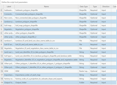

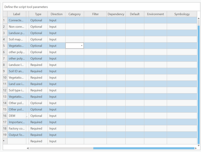

Here is all my parameter definitions, there is no multi value.

you apparently have 19 parameters.... which is the parameter in question?   You need to scroll to the right to see if the multivalue option is specified.
Also, if your getparameterastext is all of them, that is why it returns a list.
