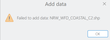

ArcPro will not recognise / load some shapefiles but load some from exactly same folder.
3746
9
02-13-2025 08:45 AM
Labels (3)
FionaWatters

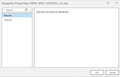

When I try and pull in some shapefiles I keep getting this errorFionaWatters_0-1739465043494.png and when I open the properties it says
FionaWatters_1-1739465043496.png. However, they open fine in QGIS so are not corrupt. I have checked the coordinate system and have tried exporting a copy in QGIS and then reopening in ArcPro and I have the same issue. What is weird is some shapefiles in the exact same folder open and others do not. So, the file pathway must be ok. It just seems to not be able to find the files. When I try and run them with geoprocessing I get this Error Error: 000229: Cannot Open. Does anyone know what is happening here?

see if getting them as feature classes in a local geodatabase helps to recover the data

Thanks! I had tried this and It doesn't recognise the shapefile as existing when i try to run it through - I get Error Error: 000229: Cannot Open

Do you still have access to ArcMap to see if shape files load in the older app?
FionaWatters
I do not but it loads in QGIS fine!

Sometimes the shapefile gets corrupted.  You can run a shapefile checker to fix some issues with the shapefile.  The process is here.
FionaWatters
Thanks - I tried this and re downloaded the shapefile from the web again and it will not even recognise it as being there

if you downloaded it from the web, go to the folder that you downloaded it to.  There should be at least 3 files with the same name and a *.shp, *.shx and *.dbf.  Perhaps the shapefile is downloaded as a *.zip file and it needs to be extracted to its individual components.

I downloaded the shapefile from here
It failed to open in Pro and GP tools failed to acknowledge it. QGIS opened it but failed to export it.
Ran ShapeChecker on it but no luck.
I was able to get a WMS working from the site but not a WFS.

If you are still stuck on this, download the data in GeoJSON format and convert to a fGDB feature class. This can be done in Pro or QGIS. Using the JSON To Features GP tool in Pro sets the Text field lengths to a huge size for reasons unknown to me. QGIS makes the a bunch smaller.
