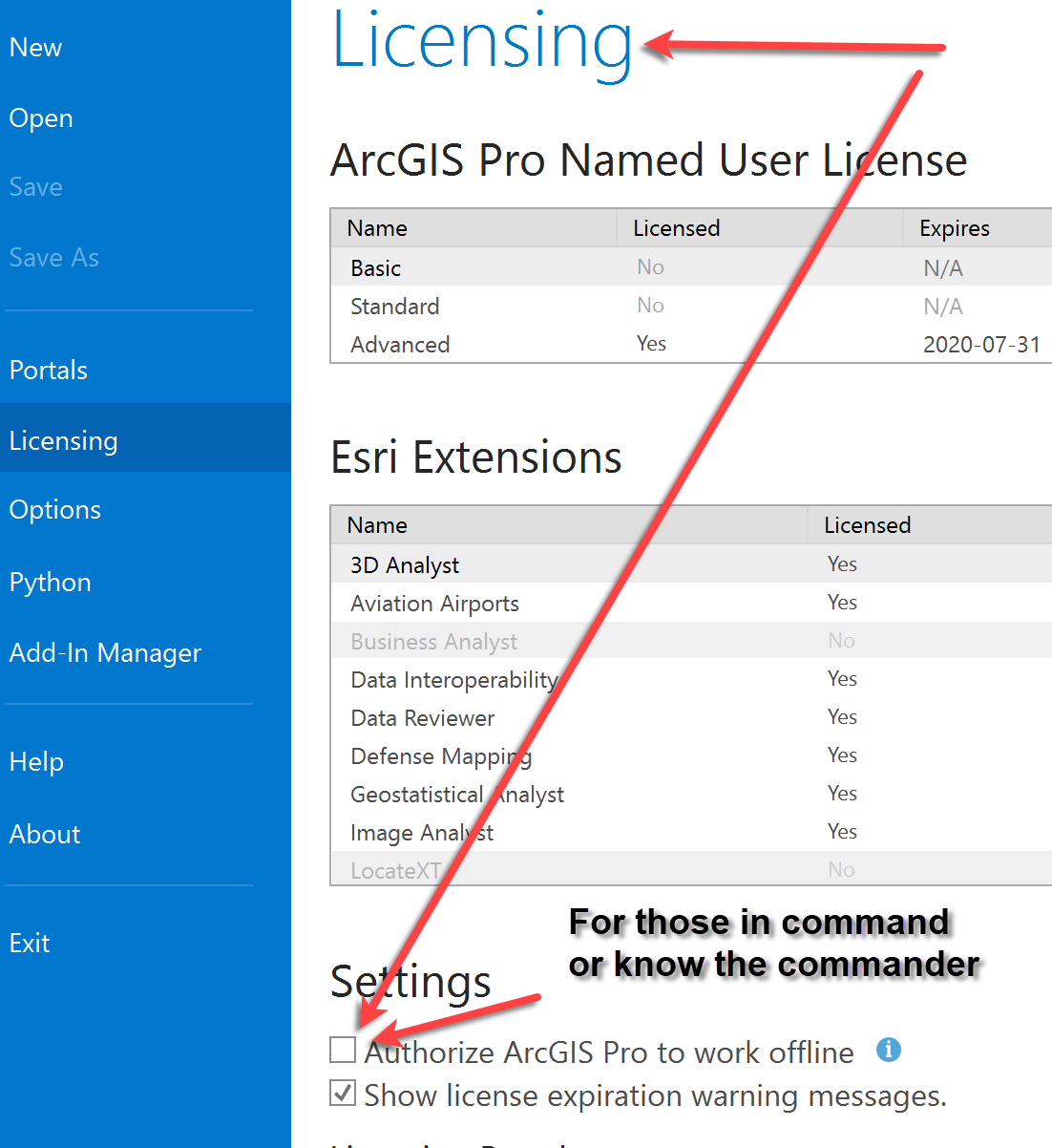

Robert... are you able to take ArcGIS Pro 'offline'
No need to run into the deepest part of the forest far from civilization to see whether it is the software 'calling home'

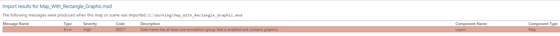

For the comment about graphics layers from ArcMap, map graphics are not supported in ArcGIS Pro (https://community.esri.com/ideas/10410-graphics-and-free-text-in-arcgis-pro-maps).  If maps are not importing at all, please work with technical support: https://support.esri.com/en/contact-tech-support
The expected behavior is that the map would import, and in the Notifications you would get an error, "Data frame has at least one annotation group that is enabled and contains graphics"
