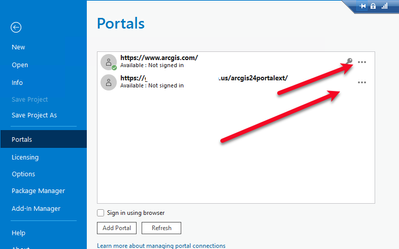

if you go to the Portals Option, you can sign out of AGOL and any portals you are connecting to.

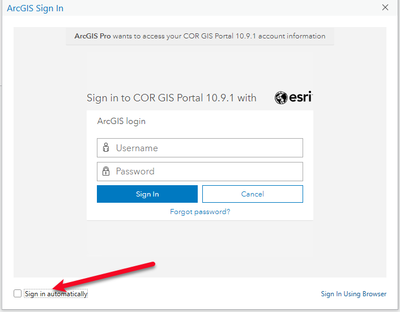

It appears that when you sign out of all of them, the sign in dialog pops up.  If not, you can then click the three dots to sign back in to get to the sign in dialog box.  There you can un-check the sign in automatically.

I tried that but the problem persists.  Our Pro signin also uses our AD and that's where the problem seems to be.  Unchecking the Sign in automatically doesn't matter, it still remembers the wrong profile when clicking the County button.  I forgot to mention that I tried unchecking the sign in automatically and signed in as a named user with no changes.  Thanks again, Chad
