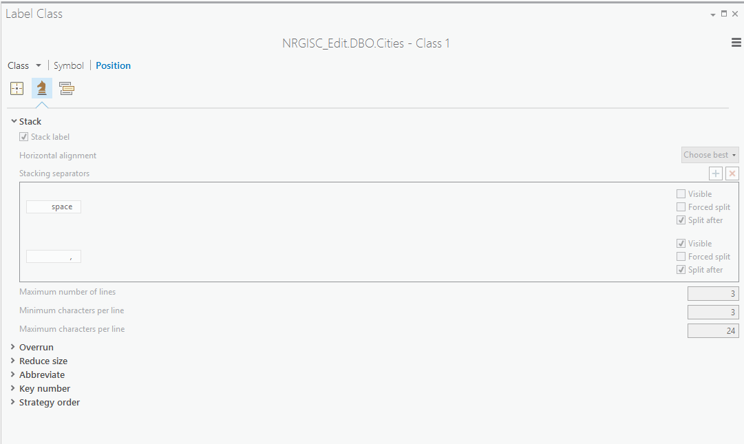

Any ideas? Label class parameters are unavailable on the feature (Positioning, Fitting Strategy, and Conflict resolution). I want to stack labels and lay down labels along the plane of the street

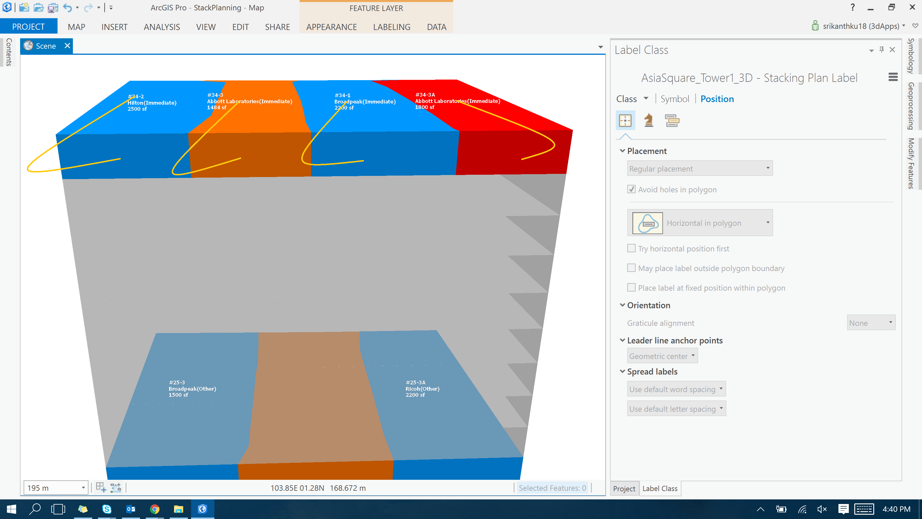

I am also facing the same issue as Brett. I am working on 3d Scene, but when try to set the position, tabs under Position menu are disabled for some reason!!. Is this bug in ArcPro 1.2?
Basically I have to position the labels of polygon on edges instead of showing them in middle. Please refer attached screenshot, appreciate your advice on re positioning the labels. Thanks

At this time it is not possible to change the placement position for polygons in 3D.  We are still working on 3D labeling for Pro.
The help topic below outlines what is presently possible.
Label in 3D—ArcGIS Pro | ArcGIS for Desktop
