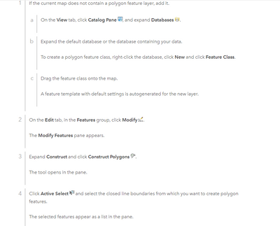

I'm trying to create a feature layer following this method: https://pro.arcgis.com/en/pro-app/2.8/help/editing/construct-polygons-from-features.htm

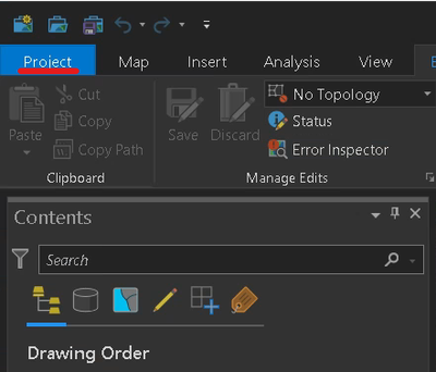

But by the time I get to step 3, I'm unable to select "Construct Polygons". This is what my Modify Features tab looks like:
Why might this be the case? I'm new to GIS, so any insight as to why I'm unable to select "Construct Polygon" would really help me out!

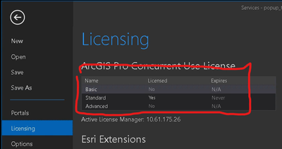

You need a Standard or Advanced license for that tool. I guess you have a Basic license?
To see your license level:
Open the Project settings
Go to the Licensing tab. This might take a while to load.
