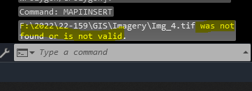

I am trying to help out a coworker pull in her imagery into AutoCAD but we keep receiving the message "file not found or not valid".

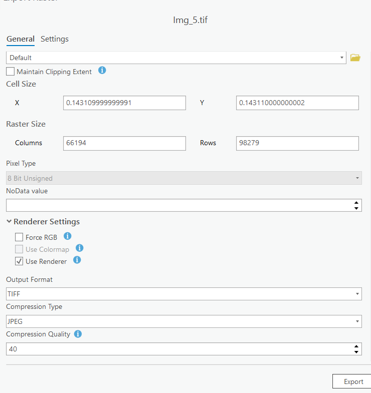

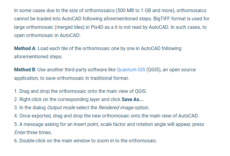

I have a coworker that collects drone imagery to use for survey work. She primarily uses AutoCAD Civil 3d however the images slow down her computer so we tried to export the raster using the Method B in ArcPro instead of QGIS.
It worked once, but since that first time, she is receiving the error:
Has anyone dealt with drone imagery or processing it so that AutoCAD runs quicker? ArcPro Settings attached below.
