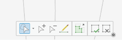

When creating new point/editing vertices etc., the editing toolbar appears on the bottom of the screen. Having finished with the edits, I click the box with the green check to confirm I am done with my edits, and then save my edits.
However recently, when I click to another map/layout and then return to the original that I was editing, the editing toolbar appears again and I have to close it down again. I have never had this problem before and it is only recently this has begun to happen.
This is particularly annoying when I activate a map within a layout and the edit bar appears and I make edits by accident.

That is odd. Which tool does the toolbar you see belong to? Can you provide a screenshot?

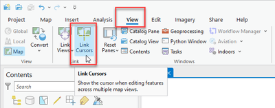

The only time the toolbar should show is when an editing tool is active. One thing to consider, is Link Cursors enabled in the project?
If so, that may explain the behavior since an Editing tool that is active within a map will activate the same tool in the layout to allow for editing across views.

For example this is the edit vertices toolbar, but it's any of the create/editing tools which have a little pop-up at the bottom of the screen like this one.
Link cursors isn't active in any of my projects.

Yes that certainly looks like the toolbar that belongs to the Edit Vertices tool. Another question, when this happens, what does the Modify Features pane look like? That's the pane that hosts the tools so I'd be curious what state that pane is in.
