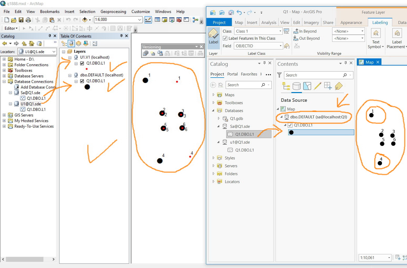

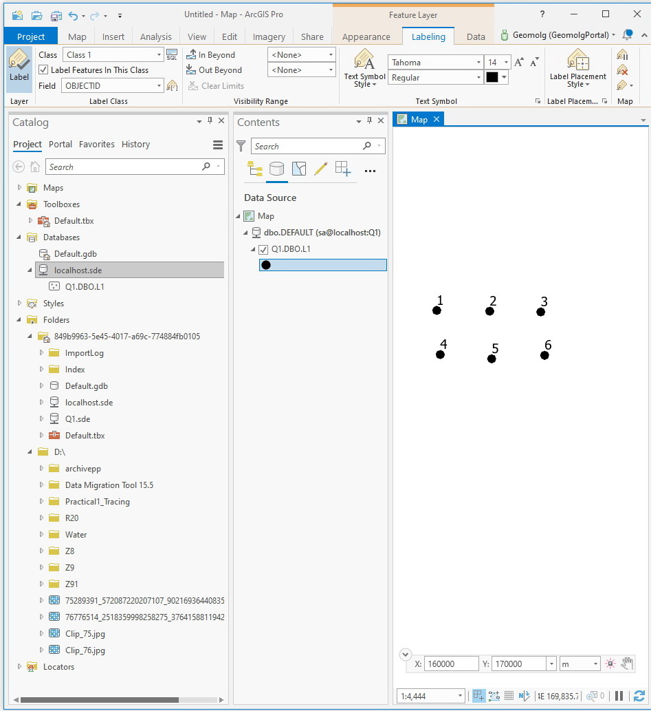

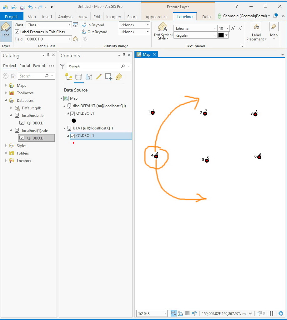

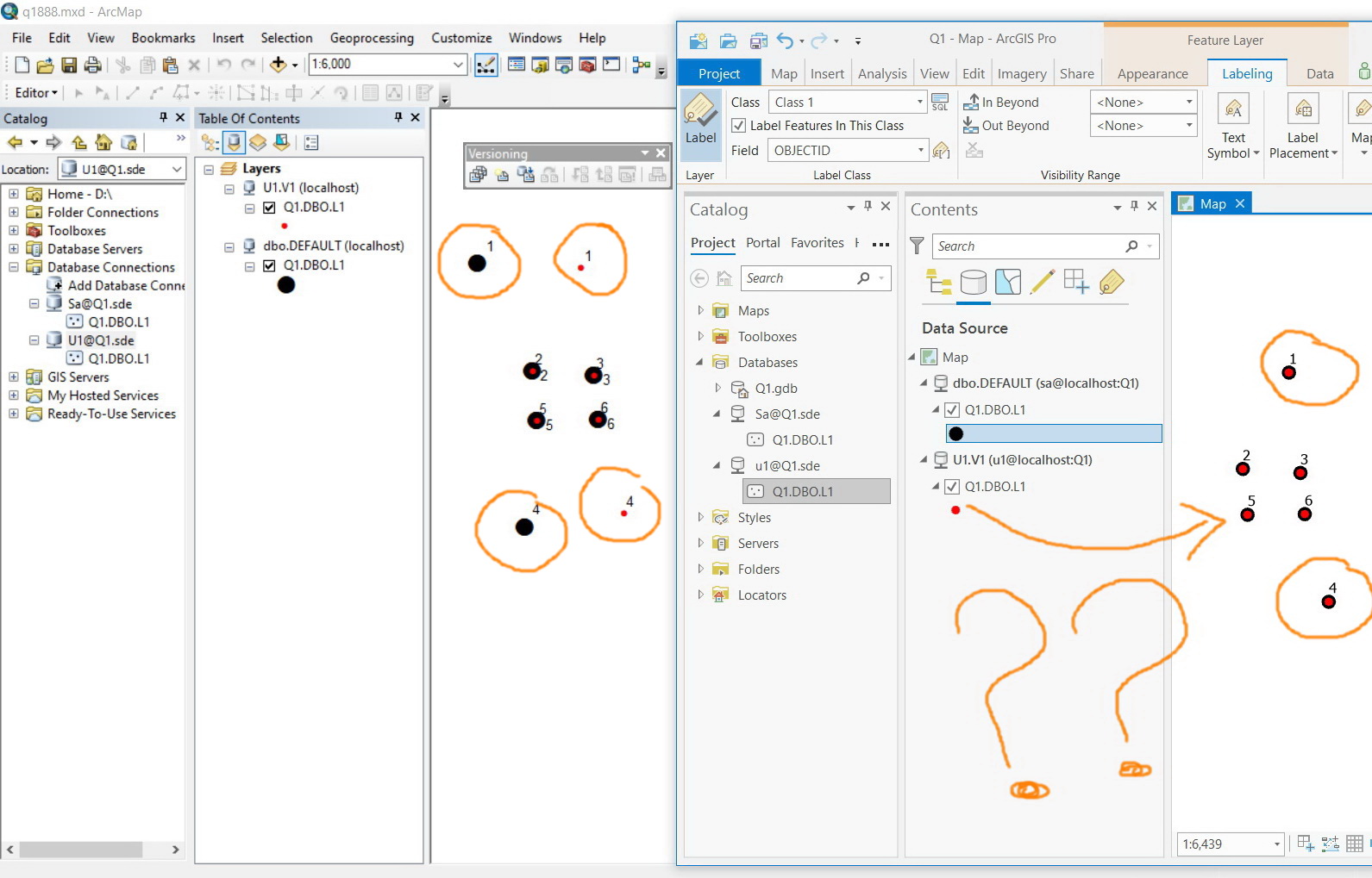

I couldn’t figure out why adding a version to the table of content gets the default version identical to it! Is this a bug?
With the same data, ArcMap is working as expected. Adding the version doesn’t affect the default to move to get identical to the version!

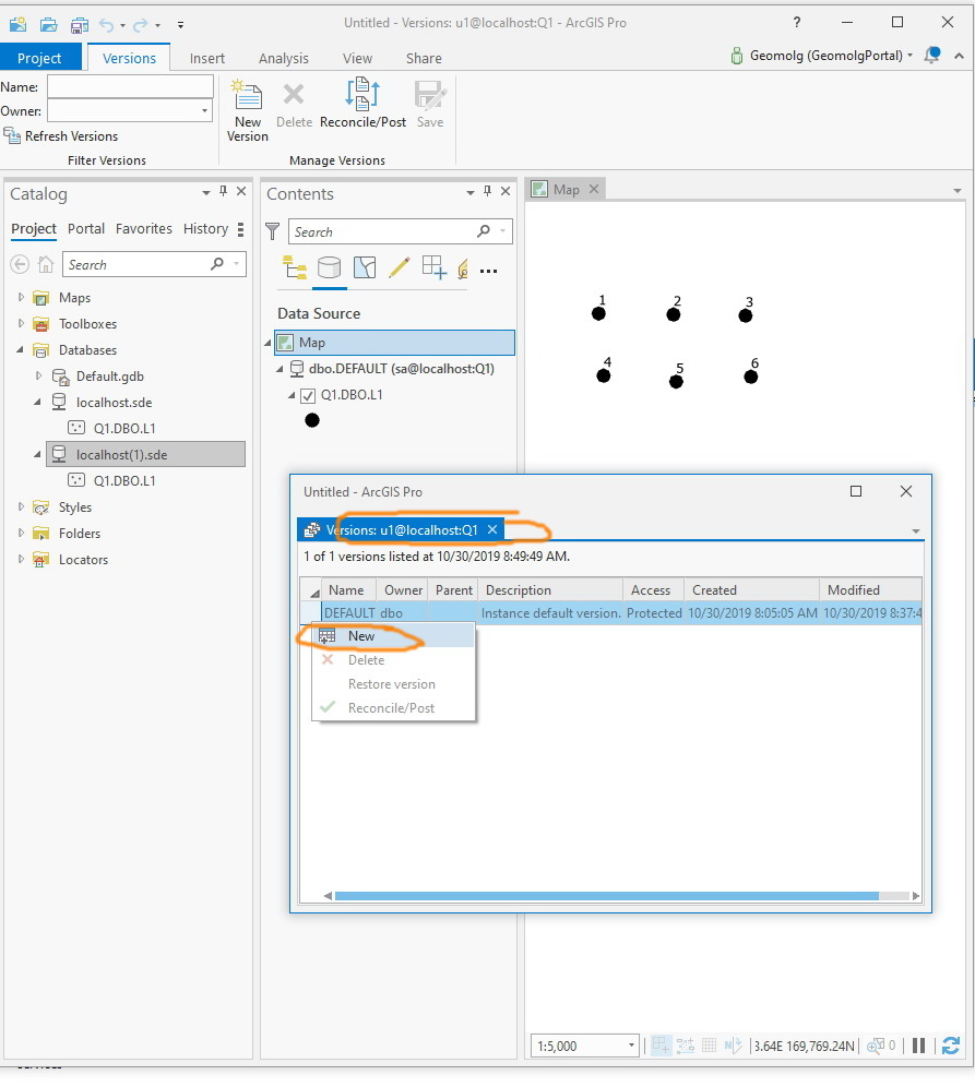

-An SQL Server database is created (named as Q1)
-A direct connection is made on Q1 by sa in ArcPro
-The Q1 is enabled as set as “protected”
-A feature class (L1) is created in Q1
-L1 is set as versioned
-6 points are created on L1
-A user (u1) is added to this Q1
-u1 is granted a full access to L1
-u1 creates a version from Q1
-u1 and sa edit the same feature
-This edited feature is expected to be detected as a conflict when reconciling
