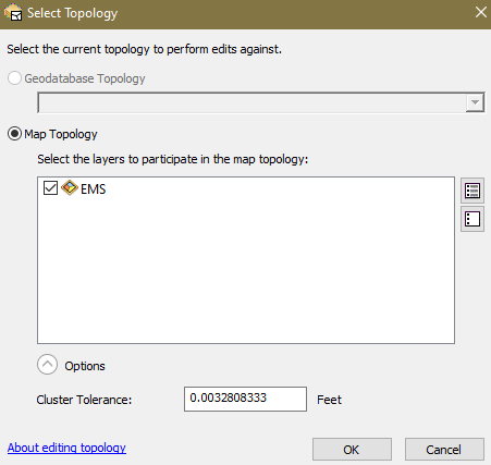

If I open a polygon feature class within ArcMap, the map topology allows a minimum cluster tolerance of 0.00328 feet:

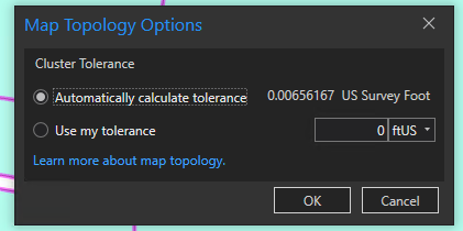

If I open the same feature class within ArcGIS Pro, the map topology will only allow a minimum cluster tolerance of 0.00656 ft (this is double the distance of ArcMap).

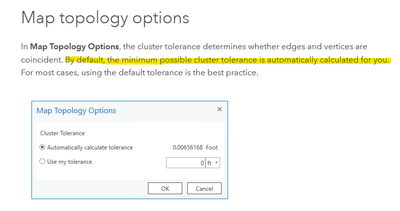

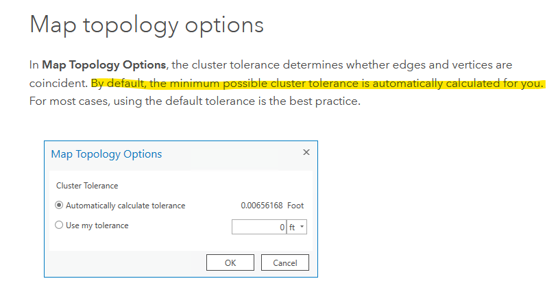

In ArcGIS Pro, I am not able to create a custom tolerance below the minimum calculated amount (per Esri documentation):
